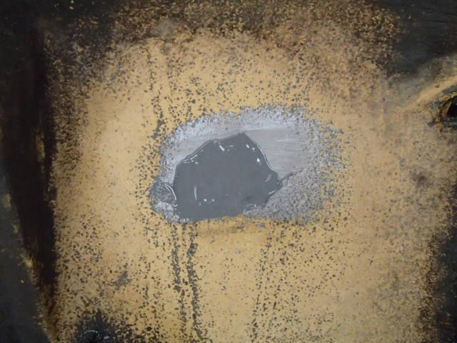

My JD400 has a pinhole in the diesel block. It appears to be a casting flaw. I have looked on the JD parts finder site and near as I can tell the diesel block is the same as the gas block. Sometimes the parts finder site has so many superseded part numbers it's confusing. Near as I can tell it is the same. I was going to degrease the hole, give it a light grind or sand and try JB weld to seal it. That would be my first attempt to repair it. It's weeping oil and getting messy. I know it needs engine work (bad valves) but it runs and starts really well. I have dumped an absolute pile of money in this machine. I was lucky to purchase it really cheap. It is really coming around and is a definite keeper. Just wondering about the block being the same as a gas motor.

Watch this and read the comments https://www.youtube.com/watch?v=vgnQmfiIo9k You could also pin it or use 310-16 rod and weld it (a little at a time)

Looks like JB weld it is. It is a very tiny casting flaw. A hole smaller than the diameter of a pencil lead. I watched the video and the follow up video. Glad to hear it worked for that guy. His crack in the block was huge.

JB should work if not then if there is not a Webb behind the leak you could drill it and tap it to 1/8"1/4".3/8" or 1/2" pipe and that would fix it also ..... NO one gives those blocks away so you could spend a fair amount of time fixing it and as you said it is very small

The other thought that just struck me is go to a machine shop that does head repair and see if they have any of the tapered pins that are used to repair head cracks. The go down pretty small, you might need to only clean the hole up to the correct size, screw the pin in, break it off, and peen the remains flat.

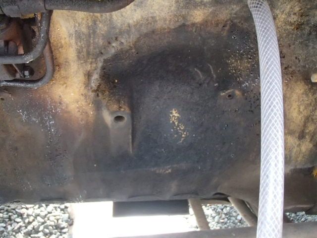

That is most likely a better repair than JB weld. I have to take some older buick 350 exhaust manifolds in to a machine shop in a couple days. I'll ask about that. I am concerned about making it bigger as I can't tell how bad the flaw is on the inside is if it is a flaw. I need to get a picture of it up here.
It has gotten messy with the thinner oil I put in for cold weather. I need to pull the pan and have a look. In my spare time. :roll: My spring and summer are filling up fast.

Well shoot... Almost a productive day. I think the peened pin might have to wait for later. I have no idea how much block material is under the pinhole. Also I have been wanting to install my coolant heater to go with the oil pan heater I put on a while ago. So changing my coolant back to regular ethylene glycol based coolant today seemed like a good time to do all this. I'm hoping I won't need to replace the block later.
Here is the hole. And a lot more oil since I put thinner stuff in for cold weather. Draining the coolant also.
Cleaned up revealed two holes although only one seems to be weeping. That moisture is brake clean.
A little smear of JB weld.
And how it sits right now. It's pretty cool here so the light will help set it up. I tapped into the block in the same places as the JD parts finder site, and the manuals.
Now that spring is around the corner.... :roll: Better late than never. Both my wife and I still think we will get a cold snap. And I am getting lazy. I didn't paint the mounting bracket.
That should hold it for now.
