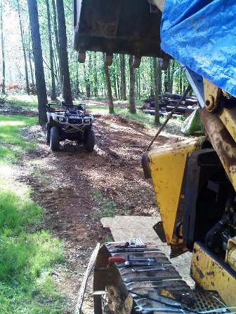

Well 'll give ya'll a good laugh for the day. I went the redneck way also. I raised the front bucket all the way up and used the winch on the front of my 4 wheeler. I chained the 4 wheeler to a tree just in case and it worked out great. I have it all back together now and shes running great(fingers crossed). The cowl is not quite as heavy as I had imagined. Putting it back on the same way I got it off was not as easy. With the bucket being so far out in front I had to get someone to run the winch while I pushed it to the front and started a couple of bolts. By the way I used some 3" channel iron to hold the cylinders out while I was under the bucket. Thanks again guys for the help.

I have to say it worked really good. Only problem is the distance between the bucket and the front end. That requires at least 2 people to pull it off. I'll post a pic if I can figure out how to get it off of my phone. OK I have the pic on my computer any one know how to put it in here?

Post by Tigerhaze » Thu May 07, 2009 8:35 am
Here you go (one too many "img's"):

Post by cinok » Thu May 07, 2009 11:53 am
I see that you also have a shop with plenty of space to work on the machine :lol: :lol:

Post by moose80cj7 » Thu May 07, 2009 3:11 pm
Yep the ceiling is really tall. It also has heat and AC climate control depending on the season.
