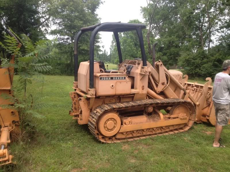

I have also decided that when I tear into the machine I am replacing ALL of the hard to get to lines. I hate down time and having to redo the same job. especially out in the still spider infested South carolina woods! Here are a few pics of my loader,
