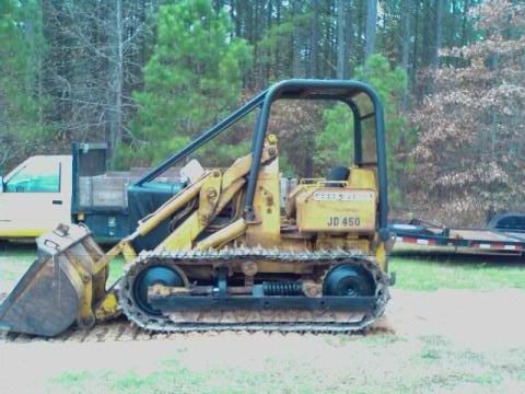

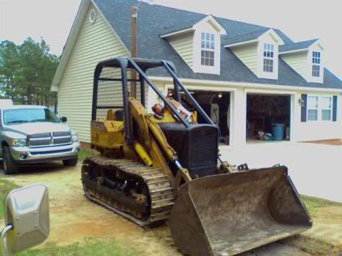

I bought this loader about 3 monthes ago to clear some land and have been working it hard ever since. I brought it home to add some cage protection the rear of the ROPS and to add limb risers.
Post by digitup2 » Thu Dec 10, 2009 11:44 pm
When stock those limb risers would have the ability to flex with the roll bar as it is on rubber mounts if you don't put flex in the system you will put big stress on the front rad mount and hard nose cowel .Digitup.

Post by JD-thomas » Fri Dec 11, 2009 5:41 am
So I should add some rubber gromets under nose mount?? Maybe 1/2" thick to give them some flexing ability? Or do you have any suggestions? And which end has the flexing ability the nose end or the cage end. Thanks for the input dont wanna create any machine problems....

Post by digitup2 » Fri Dec 11, 2009 6:01 pm
Some flex in there would be nice .It would be a lot easier on the rad and mounts .Digitup.

Post by JD-thomas » Fri Dec 11, 2009 6:57 pm
Thanks for the input I will add some rubber bushings and lock-nuts so I can run the bolts snug and not tight.
