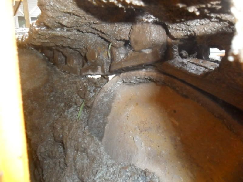

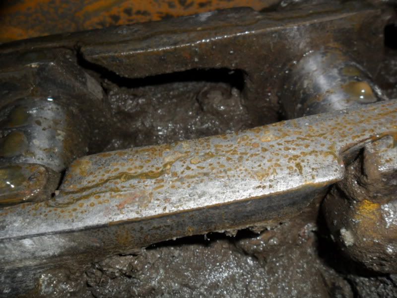

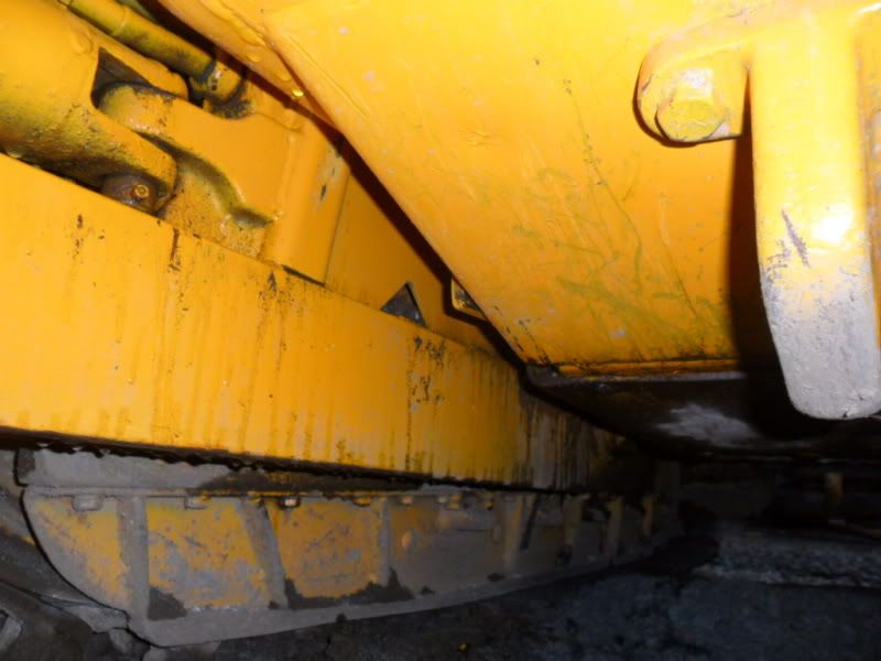

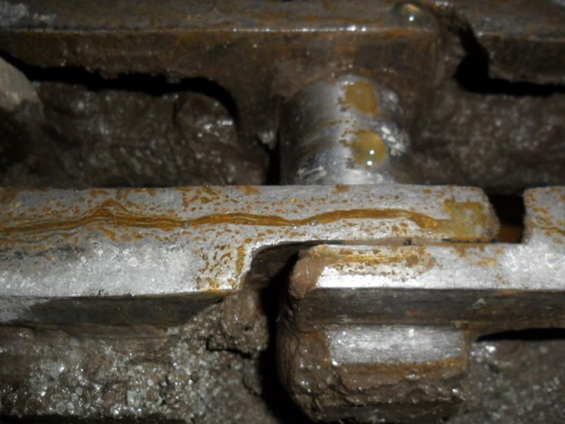

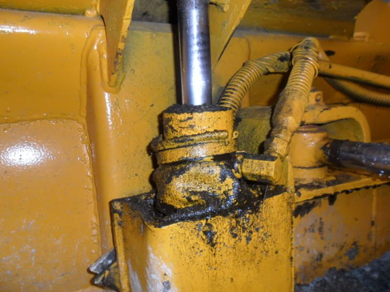

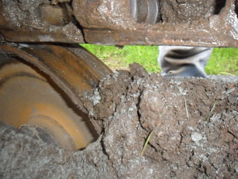

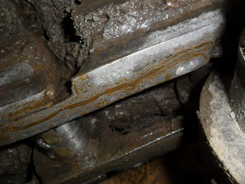

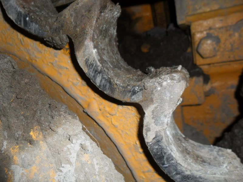

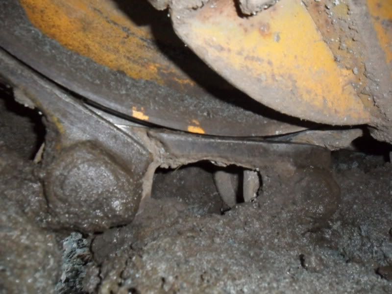

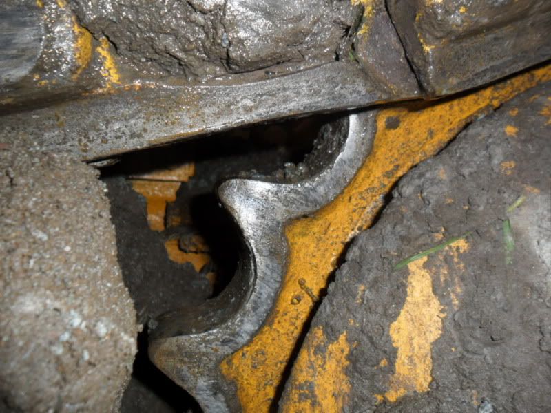

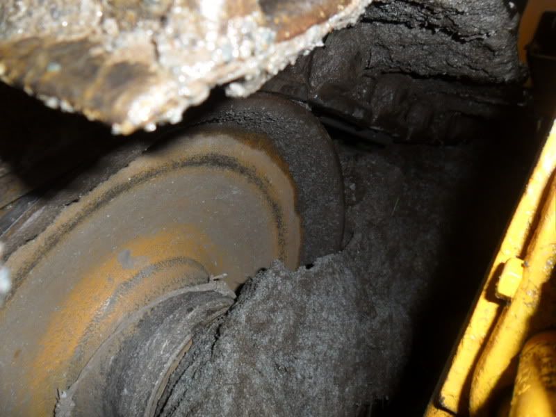

Hi !
Here are some more pics to help find out if this dozer is in good shape .
shnock , forgot to count the amount of grouser !! I have to go by there anyway so i will keep you up to date with this !!

looking for crawler dozer
hi Andre, i counted the pads on the right and left sides as best i could from your first set of pics and i came up with 36 on both sides. they look pretty good from your second set of pics but you should still do the measuring as the other posts advised. good luck on your crawler journey!randy from michigan
