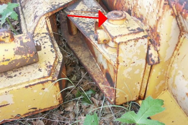

What is the best way to weld this back?
I have a Lincoln 220 volt "buzz box" that is a/c and d/c. Do I need a special material rod since I will joining the chrome rod to other metal?
Do I need to grind any off and if so, how much?
Looks it broke at a joint that was welded.
This is the ram that angles my blade, JD 64.

Hi: I think the knuckle was originally spun welded to the shaft which usually give a strong consistent bond. If you try to weld it in place now, you will probably get a better weld on the top as compared to the bottom - due to access, which will give an imbalanced joint which will want to tear over time.
I'd encourage you to get the knuckle and shaft off the machine to do this repair - it will allow better alignment and the ability to do your best welding which will hold up better in the long run.

I did not spend much time with it over the weekend but that pin seemed to be really stuck bad. It has no cotter pins holding it in place, it is wedged in there. There seems to be no bottom access to push or heat this pin.
That is why I was considering welding it in place. If I could get the pin out, it is a no brainer to grind, and reweld.
There is suffcient access to the rod on the bottom so with careful and planned welding, I believe it could be fairly consistant.
My wire elder would do the trick as it will get in there with no problem, as long as I learn to weld standing on my head. :lol:
I believe that stick welder will get in there, will just be a little more effort and time to make it right.
I can tack the top and side portions, then raise the cylinder on the opposite end to gain good access to the bottom area to do my fill and finish welding.

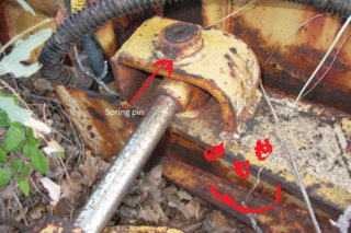

I think the pin is held in place with a spring or roll pin near the top or underneath, which is driven out using a spring pin punch (a drift with a raised center dimple that allows you to drive out without expanding it). The pins are pretty hard and wont drill out, but I've used a torch to heat them up through the center and then gotten them out with the punch (I bought one especially for my lift and angle cylinder removal) - the heated spring/roll pin will need to be replaced.
Are you sure that there is no room to allow the pin to come out ? I couldn't find a blade/cylinder parts breakdown online for your machine - sorry.
Good luck which ever way you go. Paul

Post by JD440ICD2006 » Mon May 14, 2012 2:48 pm
This pin has no cotter pins or other type of fasters to hold it in. I can see the hole on the top end.
It is in there and not sure how I would pull it out.

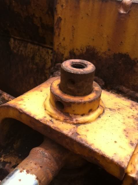

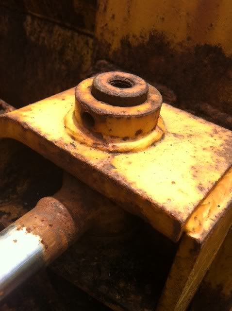

I have a #64 blade, s/n 627, not on a crawler and I just went out and looked at it. On mine the cyl shaft reduces down to 7/8" and is threaded into the end and locked with a setscrew thru the side of the end. The pin has a collar on the top with a roll pin thru the collar and pin, but also the end of the pin is threaded either 1/2" or 9/16" in the center. I would think if the roll pin was removed some sort of puller could be threaded into the threads in the pin to remove it from the top. There is no way it could be driven out the bottom. None of the cylinders, lift or angling, on mine have any welding where the ends attach to the rods.
Also one of the cylinders has the threaded end broken off on mine, that is how I could determine it was 7/8 threads.
