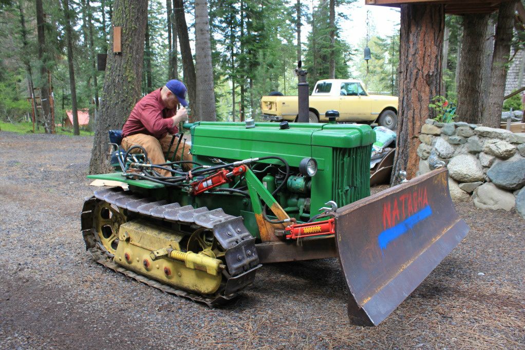

One good MC and several part machines.
Here is one of the pictures.
The angle blade was a home grown creation and works great for pushing snow of our road.
The name on the blade came from a over exuberant young man many moons ago who found a can of red spray paint and had just finished reading a history of some battle where Soldiers used a large dozer to take an objective...the author stated the dozer had Natasha painted on its side....since then the name has been repainted a couple times.
(I cant remember if it was a Battle in the Pacific during WWII or a history on one of the Israeli conflicts)
Rob
Rob
