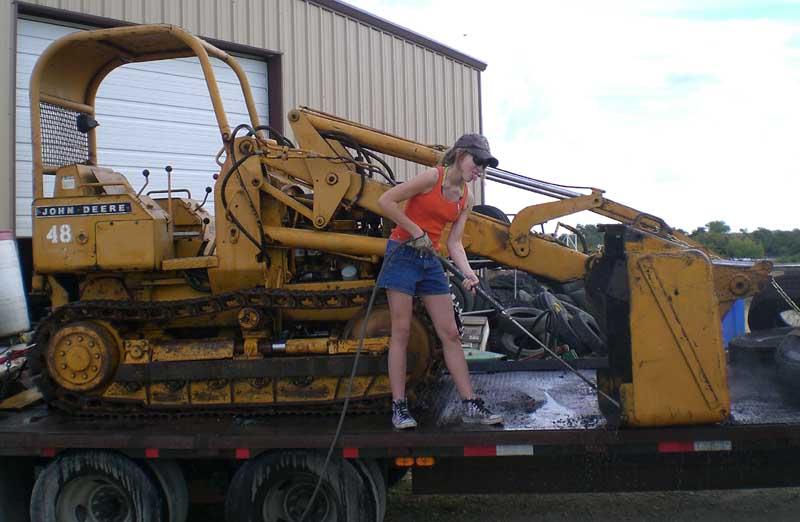

Getting a nice steam cleaning before she goes into the shop (courtesy of my 12 year old niece) Heave equipment sauna.

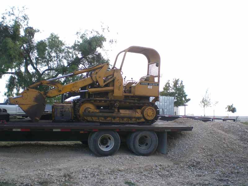

Finally coming off the trailer

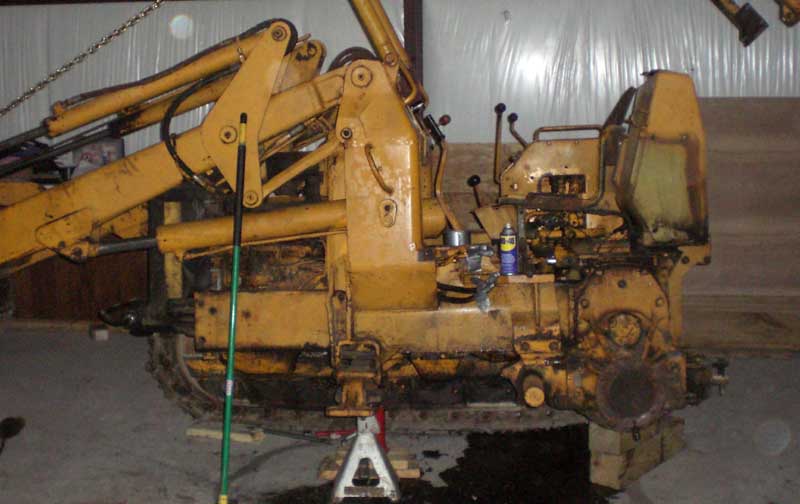

In her new home, and already got her left shoe off on the first day

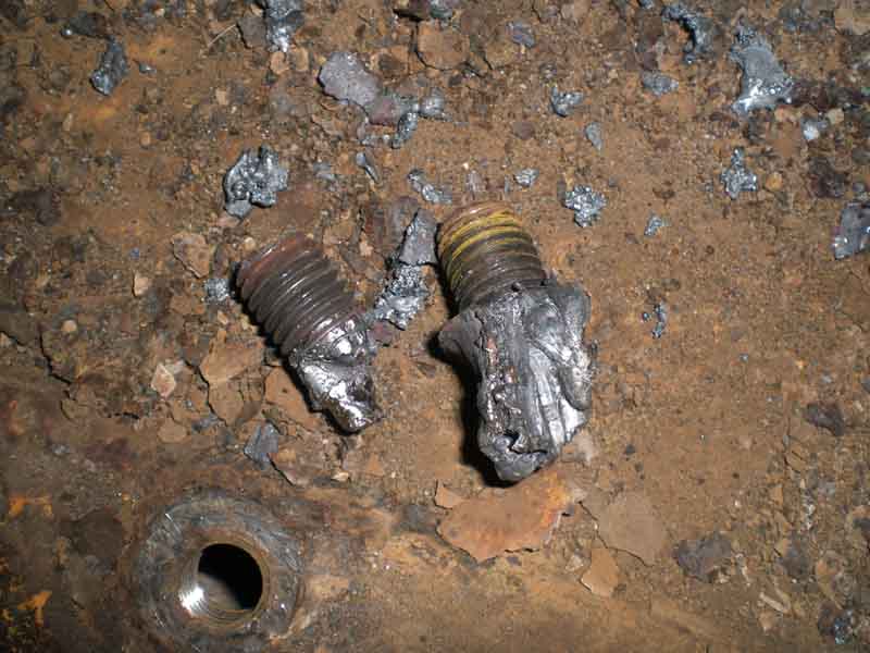

She started to put up a fight so I had to take out the torch, lucked out though and was able to get them out without damaging anything but the actual bolts, threads in the track frame look great
I may have got carried away, but it was a lot of fun and great learning
