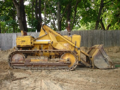

Attached is a picture of it (the counter weight is not on in the pic)
I welcome all comments and questions at anytime on any subject and look forward to sharing more pictures and stories of its use, repair and maintenance.
JD 2010 Crawler Loader 7,500+hrs. and still ticking
