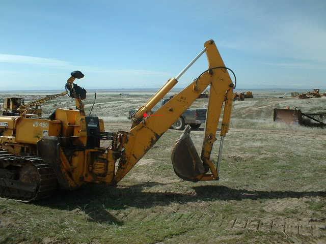

I have an old 450B on the weekend i was using it and got a small leak from a hose on the backhoe (picutred marked red dot) but kept working as i was only using the 4in1 on the front and not the backhoe, then about 1/2 hour later the line blew off on the backhoe and oil sprayed out under alot of presure.
I reconnected the hose on the backhoe but then nothing on the backhoe worked!, the legs didnt go up or down and the bucket wouldnt move or swing L/R, (the 4in1 still worked fine) however when i disconnected one end of the hose and faced it into an empty drum, oil would flow out upon start up of the machine and the legs would go up/down and everything would work again but when i reconnected the hose nothing on the backhoe worked again.
i also noted that when the hose is connected the machine wont move forward as quick however if i raise the 4in1 while driving forward the machine moves abit quicker?..
(simular machine)
- Should oil be flowing out of this line (when disconnected) upon start up without moving the lever ? ? ?

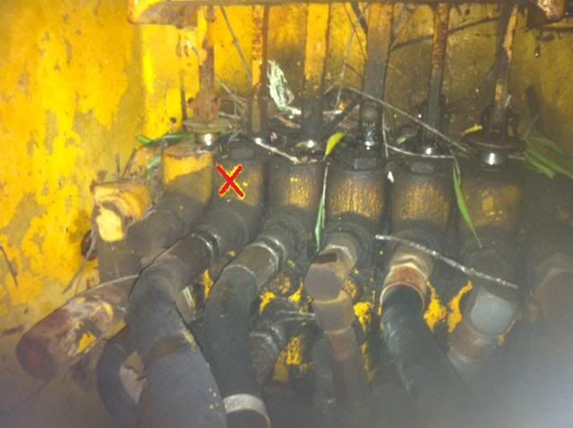

i disconnected one end of the hose and faced it down into an empty drum then turn the machine on and it started filling the drum. i tried the lever forwards and backwards and it was blasting the oil out like crazy!, i found that there is no neutral position in the lever where the flow stops!, so its constantly flowing so thsts where the problem is!.
Just to test the theory i disconected the hoses off one of the legs and it would only shoot out oil if i hit the lever.
This is the problem lever;
doesnt seem to be any adjustment that i can make to the unit at first glance.
What do i need to do now?
Looking n learning!..
LeonardL
Posts: 916
Location: Missouri
Post by LeonardL » Tue May 15, 2012 8:17 am
Take the valve apart and look for a broken spool. If you don't have any control at all with this particular circuit, then I would suspect a broken valve spool. This is what is allowing the flow of oil through the valve and out through the hose.
