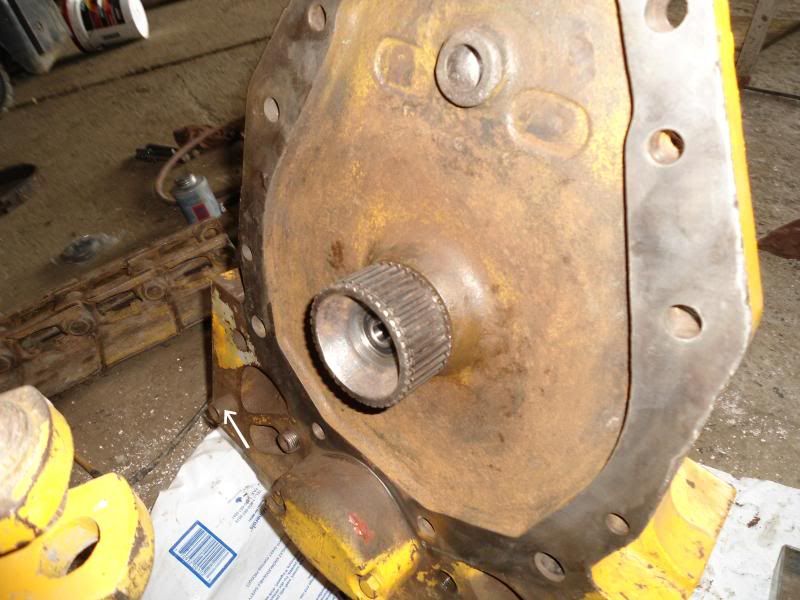

Hello !
anyone knows if this part ( see pics at the red arrow (lower left hand side of the pic) is available or if there is a partnumber ( can't find anywhere in my books nor on JD-part website .
it seem to be a bolt that screw onto the casing but the head is also inside threated to accept the bolt from the drawbar bracket.
there is still some thread in there but not very nice so I would like to fix it.

Normally the thread inside of the bushing is only used to remove the bushing, so I would not worry about it.

Try searching in your parts book or the website for a T43702 or M2323T, I believe Deere calls it a "dowel". Lavoy is right though, its just more or less a bushing or spacer , the threads for the bolt that attaches it should be in the final drive itself.

The bolt for your draw bar actually threads into the final drive housing. The bushing is what the draw bar pulls against. Lavoy and Catd8rII are correct in that unless you just want new ones it is really not necessary to change them out. As Lavoy pointed out the threads in the bushing or dowel is only used to remove them.
