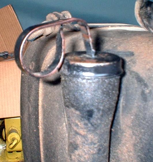

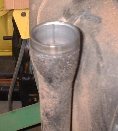

Thanks for the reply. I'm beginning to think I may not have all of the dipstick tube. Could there have been a "two piece" tube at one time?
The serial number on the cab is 240453T and I only suppose it's the original cab. The more I look at the tube, the more it makes me think that it's missing an extension that would allow the dipstick to be pulled from the door on top of the hood. I'll post this picture/link and see if this makes sense to anyone.

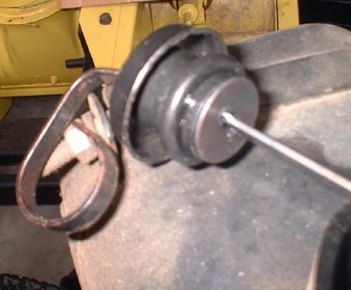

The engine covers have long been removed and unless there was a door on the cover, the dipstick would be really tough to get to with the covers in place. Also the cover on top of the dipstick would be abnormally large. We ordered the dipstick p/n AR69686 and it was too long but I think now it may have been the correct one and what I'm missing is part of the tube. Only problem with this theory is that Deere only shows a one piece tube, not a two piece, but maybe that's just the way they drew it as they only sell both as a unit maybe.
As Digitup says, "If Deere sent you a longer one that fit the tube and sealed properly"...cut it to fit, that's what I would do but none have even come close to fitting over the top of the tube. The one I made is a Ford dipstick but I used the plastic cap from a can of Kroil to cover the top of the tube. It aint purdy but it works for now...
So maybe what I don't know is how the oil dipstick is accessed with the engine covers in place. I think I would like to replace the covers as sooner or later they will prove worth their hassle.

The dipstick that fits that tube in your picture would have a rubber expanding plug on it that fits the belled end portion of the tube... it would have a tightening handle above the rubber plug.
I had one like that on a 4 wheel drive loader, but I have no idea if that was the type used originally on your 550. A friend of mine had a 550 and it seems that he checked the oil from the top of the hood with a long dipstick... it was 25 years ago though, so I could be wrong.

Digitup, you may very well be right. It may have been added as a fix for something... but, it IS painted yellow... MUST be original!
Heck after 30 or more years, who knows?
But, he may be able to fashion a workable dipstick with what's there. Found another Deere product in my garage that has a belled dipstick tube. The tube has an ID of about 1 and 1/8 inches. The dipstick itself has a rubber plug with a raised ring that fits snugly in the hole. There's also a metal cap that goes over everything when its inserted. May work for this application. Just need to get the right length of dipstick rod to fasten on.
I suspect any small mower repair place would have a bunch of these laying around. Its a Kohler K181S engine that was used in LOTS of small machines. This one is my 1969 Deere 110 tractor. Another Deere product that's still working fine after 40 years.

Actually the perfect dipstick is on an old International truck motor behind my shop those sticks twist seal tight .It is on an old DVM555 motor If you could find one you could shorten it to work but .I would put side screens on that old Deere again as they are needed on a dozer that size and install a proper dipstick that pulls out the top service door of the hood .If it was mine I might not do it tomorrow but that would get done .I have built side shields of 1/16 plate and put a belly out in the plate on the alternator side just far enough for alternator clearance .Digitup.
