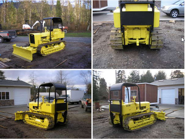

I'm attemtping to post a couple of pictures of this
Post by Dennis » Tue Mar 13, 2007 10:38 pm
Hi Again,
I thought I would attempt to post a picture to see if this might help with deciding what this is and it value.

That unit is a 1968 build and in decent shape by the looks of things.I would have to change the color though .Use the old deep yellow color for originality the newer color is a shade creamier yellow and my old 350C wide track was painted that way .I blasted it and got the old proper yellow to look right . In the 80s Deere went to a led free color and that is why the color change happened .So if you can get past the led induced contact high when you paint it . Just keep the kids from chew en on it after if you know what I mean.The roll bar is black along with the dash and grill also . They are a nice little play toy .I took my blade and added a sheet of stainless to it .I only use it in the mud and peat bog .As low land in my area is high in acid and the blade would rust up in minutes after you shut it off .Mine wont get many hours on it so I don't have to shine it up later this way also.You should be able to get that amount for it plus on resale if it is the right color and in good shape it is worth nearly twice that .So see if you can find the JOHN DEERE side plates for the hood and a sticker kit should do the rest of the dress up job .Lavoy may be able to help you with these parts .Digitup.

dont be fooled by a nice paint job, that is the cheapest part of fixing a dozer. often times people will but a worn out dozer and paint it up to make it look good for an unsuspecting buyer. I just bought a 350 with a winch in washington for $6200 with a near perfect undercarriage, just stuck steering clutches from sitting 5 years. if you can work on them you are much better off finding a machine that no one has prettied up to sell. just my opinion.

I also noticed on the photos that the left track is on back words no big problem.The front idlers are riding on the back of the guides that is a good sign the tracks should be in good condition .If they ran the tracks that tight I would slack them off a bit .It looks like it was kept decent .Digitup.
Post by Lavoy » Sun Mar 18, 2007 11:47 am
The thing I question is it appears to me that the track adjusters are at about the end of the track frame, so I would assume the pins and bushings are shot.

Thats probably why its for sale Lavoy! New chains without pads are about $3000 from Deere. Also I thought that JD switched from "old construction yellow" to the new stlye on Nov 1 1991 or 92, I can't remember but its labeled right on the spray can.
Post by Lavoy » Mon Mar 19, 2007 8:59 am
The yellow on that one looks to me like "paint code 99 on sale at the local hardware store yellow."
I believe you are correct on the changeover date for the new yellow.

If I blow that up it just digitizes all to a blur you are correct about that tracks are worth a lot for those 350s .Mine are in nice shape but a friend of mine has a ZBT trencher made in Sarnia Ontario and that is what they user for cutter chain on them .Every year he gets a new chain for that trencher He says the price is going through the roof on that track size as they don't sell as much any more.I would guess that it has something to do with the fact that they quit making a machine for that size of track in 1997 .Digitup
