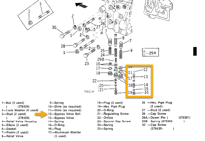

Below is a diagram of the Reverser Control Valve with pictures of the one in the dozer I am working on.
This shows the two (2) test points that are 1/8 NPT plugs and the regulating valve plug locations on the bottom of the valve body:

The next step was to determine if the issue was in the Reverser or maybe the Clutch Valve Housing was leaking and allowing pressure to return to the sump.
So we disconnected the hydraulic pressure and return lines to the Clutch Valve Housing. This required the use of two modified open end wrenches (ie grinding the sides down enough to be able to rotate the fittings.) The pressure gauge was connected to the pressure line (#32 in the diagrams) using the 6-JIC adapter.
The tractor was started and the gauge read 25psi. This seemed to indicate the issue was in the Reverser and not the Clutch housing.
On a previous trip to work on this dozer we had the Clutch Regulating plug pulled out with the penny shim and spring removed. The spring went back in very hard. With this in mind we thought maybe the valve was stuck in the bore. We pulled the plug (1 1/8" socket required) and removed the penny and spring. I could feel the end of the control valve but could not get it to move up or wiggle or anything.
Luckily the owner had another valve body laying in some leaves. This "spare" unit was also from a 350C. We removed the Control Valve plug, found three washers as shims and a duel spring assembly. The valve was stuck in this unit, most likely due to sitting outside for a looong time. We sprayed it with a bunch of WD-40. Then, with a tap from a punch and hammer, we got the valve to break free. We were able to remove it and then re-insert easily. Pushing the valve all the way in we took a rough finger depth measurement to compare to the valve position in the dozer. The dozer valve was way low in the bore and stuck, thus allowing pressure to bypass.
I was able to get a 1/4" socket extension into the control valve hole and then pry it up against the valve. The valve broke free and moved up a lot. It moved up enough that putting the spring and shim back in was A LOT easier.
We started the dozer back up with the pressure gauge still connected to the pressure line (#32) at the clutch housing. The gauge read 200PSI when the reverser was in forward or reverse. This was a major change from the 25psi we had early. The pressure dropped to zero when the clutch was pressed, or when the reverser lever was put in neutral. It appears to have shown the issue was a stuck clutch pressure regulating control valve.

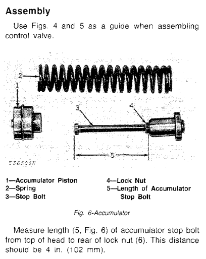

One thing I would like you to try is backing the rate of shift screw out until it is in the full on position. It is located behind a hex plug positioned in between the two plugs you have numbered as 16 and 13. Remove the plug and reach in with a small flat blade screw driver and you will feel it engage the screw slot. Turn it counter clockwise to back it out. Three or four full turns should be close to full on. This allows immediate engagement pressure to the respective clutches. Again forward or reverse. Then check your pressure again after doing this. I'm suspecting you have either some varnish or a bit of debris caught in the orifice on this restrictor. You can fully remove the screw and check up inside to see if it is plugged up. Since you have an extra valve body you can remove it as well so you can see what I'm talking about.
Another thing to check if you haven't already is the accumulator and the clutch valve itself. You want to make sure the accumulator spring adjusting bolt is where it belongs and then the actuator itself has not slipped its position or is badly worn. We have had guys on here find those yokes worn and not allowing the clutch to engage all the way. Thus throwing your pressures all over the place. You can check this with the valve body still in the machine. Remove the end plate from the valve body to check this. Bear in mind that it will be under spring tension and to be careful removing it.

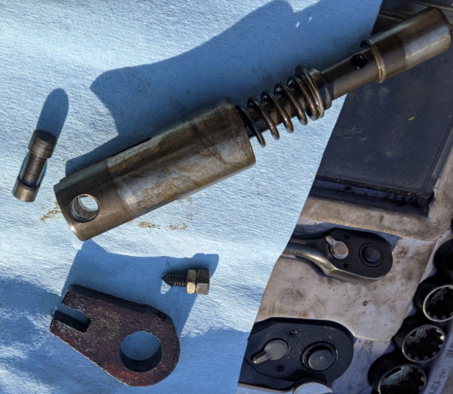

9. disassemble the accumulator housing and check:
location of spring adjusting bolt
actuator for proper location and any wear
check yoke for wear (if worn replace with one from spare valve body, assuming that one is good)
check shifting pawl for full engagement
check condition of the clutch valve (#28)

I thought the clutch regulating pressure valve might be stuck again. I could not get the valve to drop out of the valve body. So I removed the shims and springs, put the bolt back in and started the dozer for just a couple seconds. The pressure was enough to push the valve all the way down.
When I removed the nut, the valve was sitting right there. I cleaned it up, wiped the bore out as best I could and was able to get the valve to move fairly free up and down. I had to use a magnet to get it to move down due to the tolerances. At this point I believed the clutch regulating pressure valve was now free to operate as intended. Still only 25psi on the gauge at the test port.
I turned the screw in the restricting orifice almost all the way out. Still only 25 psi
I then pulled the bypass valve out. It came out with the use of a magnet. It looked good. I had also pulled the bypass valve out of the spare valve bank to see how it looked. The spare valve bank was laying flat on the tailgate of a truck (this will come up later). I assembled everything and tested pressure again, still only 25psi.
We took the accumulator apart on the spare valve body to examine it. The parts in the spare unit looked good, we did not take the clutch valve out.

There is also some wear on the clutch valve piston shown below. It looks like the valve rotates while in operation and the pin is creating a groove in the piston. The piston from the spare unit had the same wear, plus the hole was oblong as the pin broke and let the valve bounce around inside the piston (no picture of that).
The wear on the clutch valve lever is most likely why we could never get much pressure. Then the set screw must have came all the way out at some point and is why we never got over 25 psi with all the other testing.
We used the valve lever from the spare valve body. It had wear on it but not nearly as bad as the original. Hopefully its not enough to cause issues for the next few hundred hours.
We also checked the accumulator bolt length. It was at 5.25 inches. The manual states it should be at 4 inches. So we adjusted it to 4 inches.
After all this we decided to put the same reverser back into the dozer. The spare one was in unknown condition and has been sitting in a field for probably at least a year. So in the time we had left we got the reverser re-installed and spent an hour trying to get the motor lined up before we ran out of daylight again.
