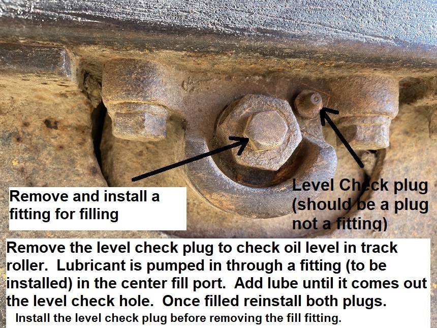

Thanks Jim B and all those who responded, this has helped a lot. Next question (i may need to start a new thread) i want to lubricate my rollers, im getting conflicting info, some say use corn grease, others say Track Idler roller lubricant (cant find the specs on that) but i have the flat style button grease nipples, im trying to find the size of them so i can get the suitable adapter for my grease gun, any ideas?

As for the lube in the rollers and idlers. The Operator's Manual shows you the check locations, proper procedure, and lubricant to use. If someone has been greasing the rollers it could be a sign the seals are blown, and the rollers will not hold the recommended SAE 30 oil. You may need to remove the fittings to see if they have grease or oil in them.
Did you try to download the Operator's Manual I gave you info on in my previous post? It will answer many of your questions without the wait for someone to respond to a question on a forum.

In this case I am going to have to respectfully disagree with your post. Here is where the correct manual comes into play. These rolls are different as far as lube instructions than the earlier ones, like the 350C. If the lube was checked properly, in 450C rolls similar to the one pictured in my post, the seals will not blow as the level plug hole being open provides a vent to prevent pressure build up. SAE 30 is the recommended lubricant in the manual. If the roll has wear enough that the seals were damaged or lube was forced in without being properly vented; the seal could be leaking and then corn head grease would be a possible lube to reduce leaking.
