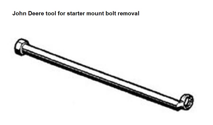

It is a pain (less than dropping the belly pans to me) but the starter can be removed from the top. John Deere has a tool (kind of a specialized crowfoot) which is an offset 9/16" 12 point box end wrench. People have made such from a cut off box end wrench and a socket extension. Cut the wrench handle off away from the box end enough to give about an inch to an inch and a half of handle. Weld a socket or extension (3/8" or 1/2" drive, your choice) to the handle to make a crowfoot type wrench. Before welding adjust the fit of the piece such that the wrench and drive side are at 90 degrees to each other. This tool can then be used with extensions to remove the bottom bolt. Best to remove the bottom bolt first so the starter doesn't drop when that bolt is removed.

My hand is just small enough to fit through the hole in the frame to allow me to hold the bottom bolt and get it out or started.
