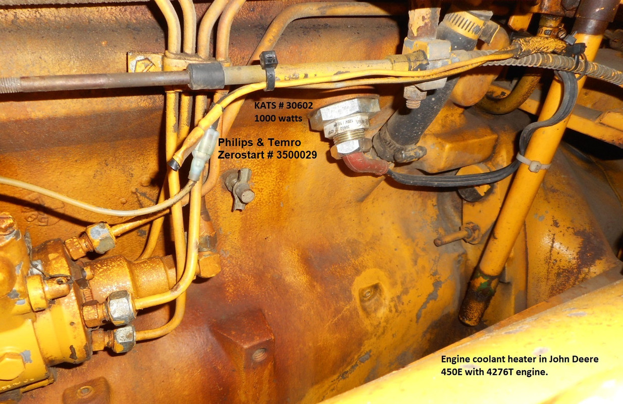

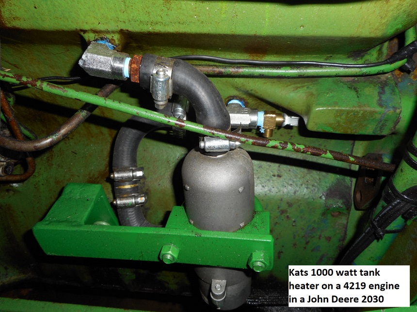

Keep starting fluid to a minimum if possible. Here are a couple options for engine heaters, depending on the head and block. First a picture of a tank heater on a 2030 with a non-turbo 4219. the second is a in the block heater on a 450E with a 4276. I don't know if there would be clearance issues with the turbo for using the tank heater and I don't know as your block has the port for the in-block heater. You can look at yours and see what might work.

Thanks for the suggestions. As far as the block heater goes, it looks like it doesn't have the port for the "in the block" heater like the 4276. However, the online parts manual shows that it had a block heater available similar to the one shown on the non-turbo 4219. I'll have to have a look and see if I can figure our where those ports are and maybe add one that way.
