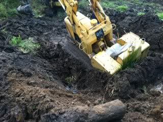

Made a big rookie mistake. I was about 3/4 done clearing some tall grass and brush from the "damp" area near my house when I hit a sink hole/underground spring. I the blink of an eye the soil turned to goo and ate the left side of the crawler. Back of the track sunk right in to the top of the track, leaving the machine tilted to the left and the front end up.

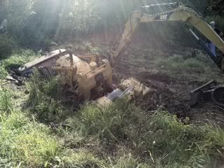

My neighbor kindly came by with his mini excavator to help dig me out. He dug the mud out around the machine, but the excavator was too small to pull it out. He ended up throwing his track so we had to fix that and ran out of daylight.
Thats about when things went bad. The hidden spring, and a good rain shower flooded the area we dug up. The machine was at a decent angle with the front end up but the water rose over the side boxes in the back and over the airfilter. Had to pay someone else with a much bigger machine to get it out.

Here is the neighbor helping with his little excavator after I got stuck. Hard to see from this pic but the left tool/battery box is touching the ground.

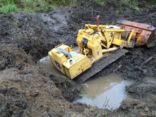

My real problems came after it rained that night and flooded the area we dug over the toolboxes up to just below the fuel cap.
I got the mud off it this weekend and drained the oil. About 2 gals of water came out before the oil did. I ran diesel through the pan in hopes to clean out any sludge. Once I get it running and hot I will change the oil again.
I loosened the drain plugs for the fuel and hydraulics and didn't see any water come out. Will replace the hydraulic and reverser fluid before I run it just to be safe once the filters come in. Also plan on pulling the injectors and spinning over to make sure there isn't any water that far up.
