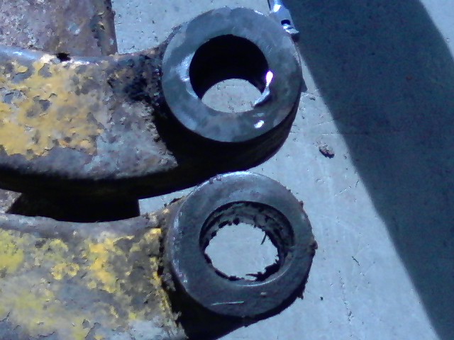

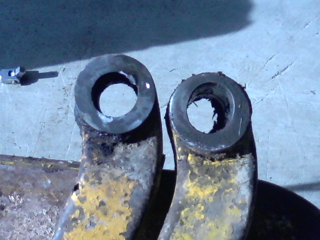

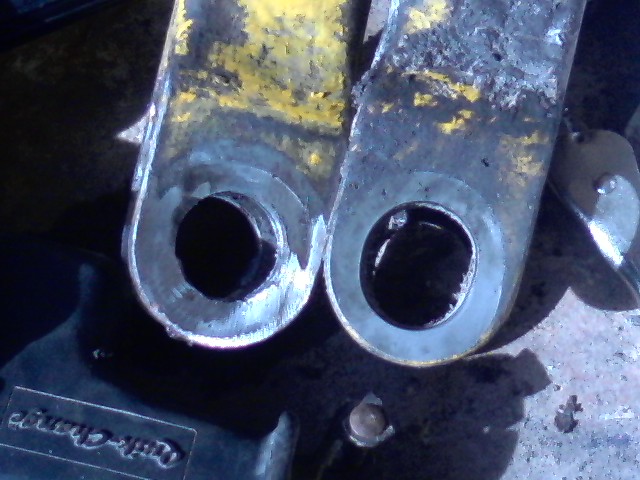

pictures of my progress
I have took a few pics of the before and after my attemped to weld the holes round again.
I have a 11/2 copper round bar and used it to help keep the round shape as i filled the gap. worked well except it was hard to beat the round bar out of the holes. so i cut a small piece about 1" long and welded one hole at a time then knocked out the copper plug and fill welded any gaps.
the copper plug in the two pics has a lip on ity from beating it out one the first side of the link which held the copper plug in place when welding the others.
I now have to file, grind or machine out the inside and touch up any low spots to make it round.
i will attemp to weld the hdy. cyl. ends the same way.

I finished my welding and grinding and it came out good, sorry i didn't take anymore pics. the hardest one was welding the hdy. cyl. ends, took alot of touching up and grinding but its alot better than before.
