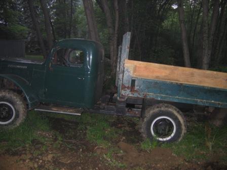

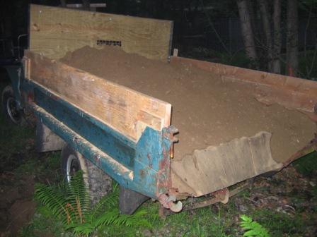

Do not try this at home. When you get your new trackloader in the sandpile for the first time, do not put 12 inch sideboards on your rusty mason dump body and load it to over-flowing with bank run gravel. I am an authority on this. If you engage the PTO and let out the clutch and nothing seems to be happening, GET OUT AND FIND OUT WHY! I didn't and I'm supposed to be a mechanic. Like Harry Homeowner, I stepped on the gas to make something happen. And when I did, as I was watching out the back window, my dump body did not go UP but slowly MOVED AWAY from me. This is very bad for a dump truck. If you look at the bottom picture, you can see my new floor worked great. It stayed together beautifully only the rusty channel steel under it did not. With all weight in the body, it sat right on the frame rails while the ram tried to push it off the back of the truck. The floor rolled very nicely down the back until the ram was fully extended.
