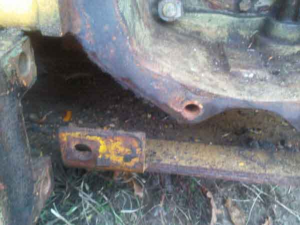

With the removal of the cap screws I did not see the bolt that holds the bottom plate to the final drive witch is sitting almost at the rear crossbar.
On the right side it is hard to reach ( the hydrolic components). On the right side you can reach it from above.

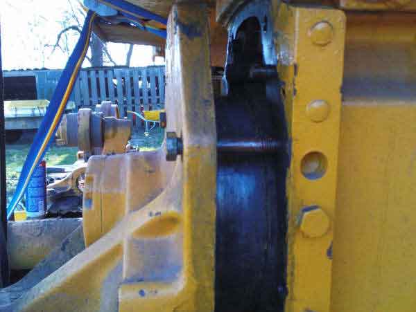

To get the final off i used long bolts to get the final to move straight away frome the tracktor.
The inner side just needed al lot of cleaning, loosning and grease.

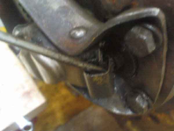

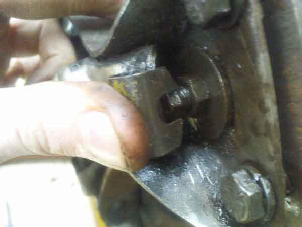

Adjusting the cluch fingers is a real pain but after i "discoverd" that the retainer is easy to remove with a small screwdriver. (you will need to release the tension from the pressure plate by releasing the 6 bolts)
(Why isnt this in the service manual?)
And the retainers will just pop back in place without much force!

Hugo; I also am new to the crawler repair business. I am rebuilding a 1010c. After reading your post I am wondering if I have made a mistake. When I installed and adjusted the pressure plate I removed the clips as you discribed, although I did not reinstall them as the pressure plates that were removed did not have them in place either. Hopefully some one with more experience will clear this up as I am reassembling the other final drive and would prefer to use the correct procedure. Any help will be appreciated . Mark

I can't give you a definitive answer as to why the clips are there, they were never a factory item, you only see them on aftermarket or rebuilt pressure plate. While there is surely no harm in reinstalling them, all mine go in the scrap dumpster.

in service manual 2063 page 140-20-1. These clips are discribed as: Return clips. So I think they are factory made.
I think they are a little bit extra to keep the 'clutch release lever' on his place.

If by clips you mean springs on the fingers, they are probably just to keep the throwout bearing from rattling. I'd put them in but if they weren't there I wouldn't give it a second thought.

I maybe should have qualified what I said. There were never factory installed on the two cylinder or 1010 crawlers. I have had NOS pressure plates over the years, and they did not have them.
