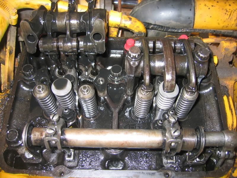

Post by JD440ICD2006 » Sun Dec 24, 2006 8:28 am
[Image

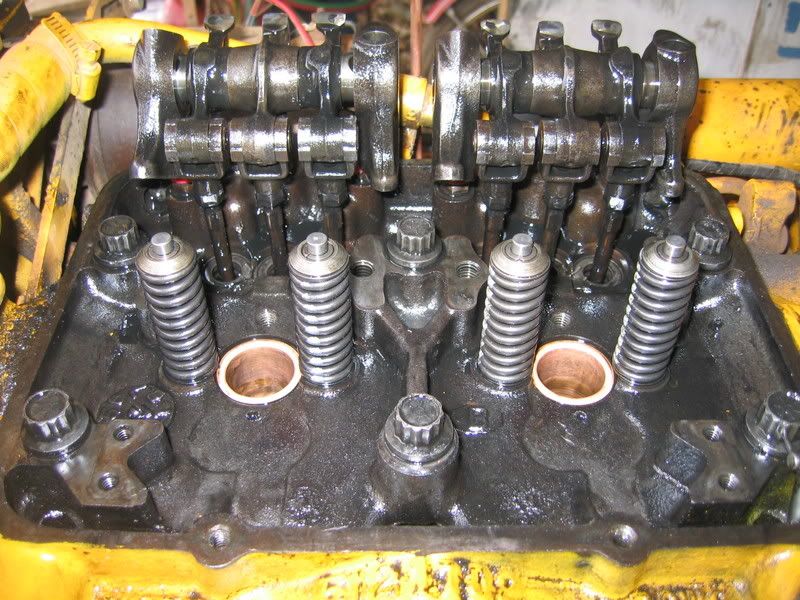

Start of job, one rocker arm assembly and old fuel lines off.
Old injectors and throttle control rod assembly removed.

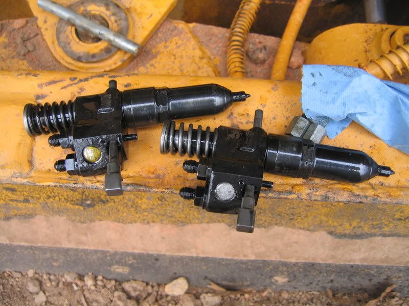

Old injectors, the one on the left is rebuilt and the one on the right is original.

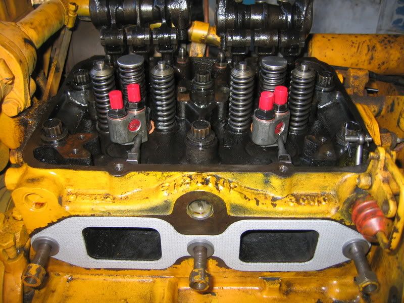

New injectors installed and torqued down, new exhaust gasket in place.

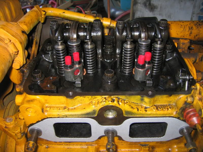

Rocker arm assemblies in place and torqued down.

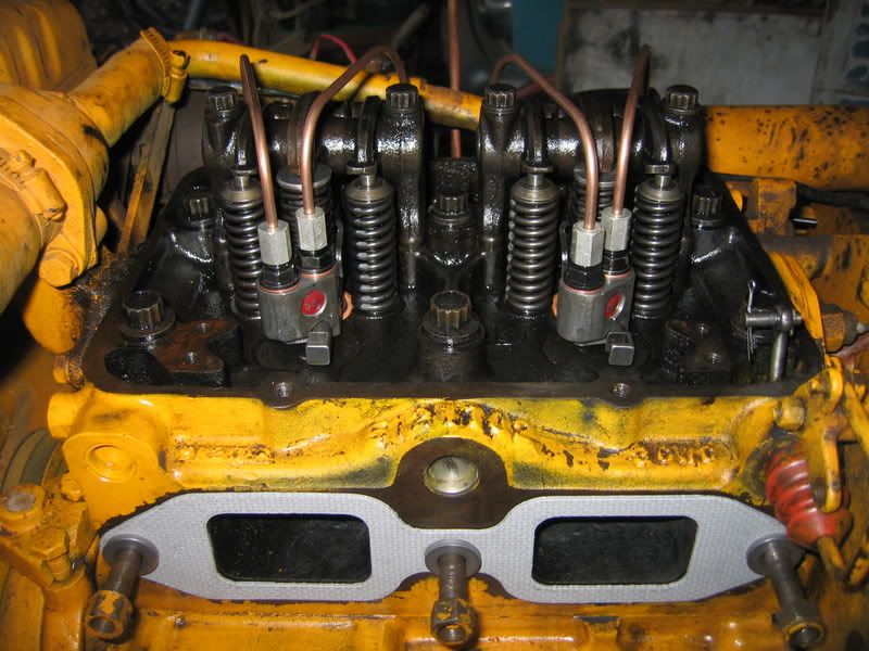

New fuel lines added. (At least one was leaking, a common problem)

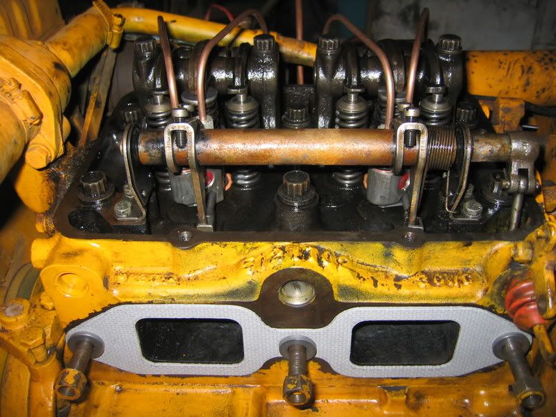

Throttle control rod assembly installed and adjusted.
Next step is to do a cold adjustment on exhaust valves and set the timing on the injectors.

Interpret for us what you see, good or bad.
Post by JD440ICD2006 » Fri Dec 29, 2006 9:05 pm
The good:
No gunk in the top end. No broken or excessively worn parts, very little wear on lifters. Good top edge surface on the head after it was cleaned.
The bad:
The top edge surface of the head had to be scraped and cleaned where someone had tried to use gasket compound instead of replacing the cork gasket, which is being replaced. Both injectors are being replaced although one was in better shape and newer, one of the pipes was cracked which was part of the fuel leak.
The exhaust manifold gasket fell apart and is being replaced.
Overall, this engine has many hours left in it. The best the DD dealer, this engine was built around 1975. It is an upgraded 2-53 with the air intake cut off butterfly in case of a run away.
The parts book list a "35" as the injectors in the original engine. The ones in this engine are "S45". They are the same spray pattern and angle, with a very slightly larger orifices in the tip.
