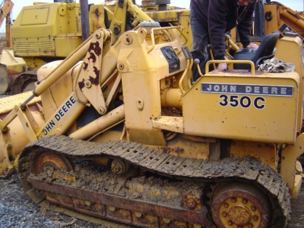

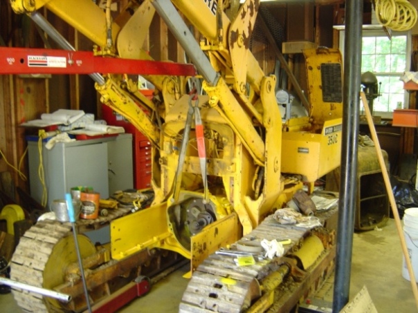

This is my 350C i picked up in Feb 06
Now the fun starts, it needed an engine in a bad way

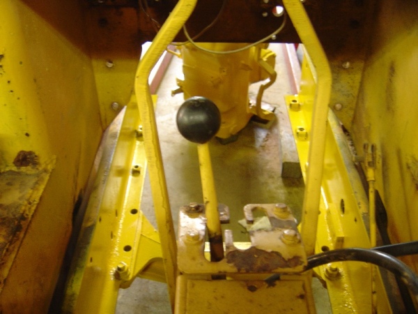

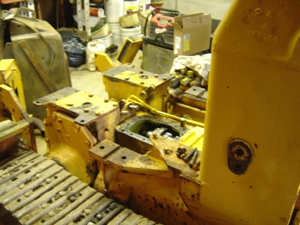

I figured the reverser should be checked too, while the motor was out

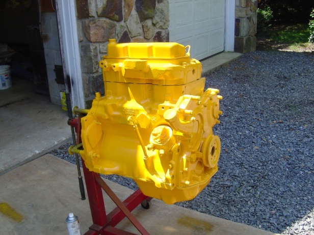

My engine (3152) with a new lease on life

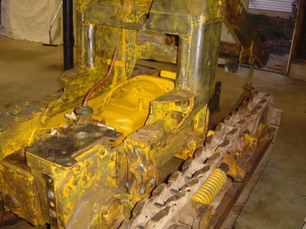

Machine minus electrical and hyrdaulic systems

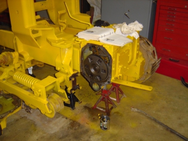

Reversers back in (pain in the butt!) and ready to paint (1st coat)

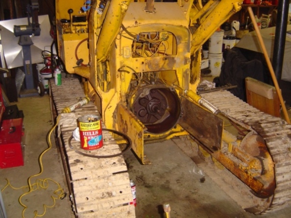

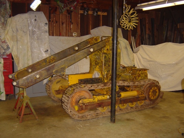

I kinda did this backwards but i didnt think i had enough room to break the track in the garage. Pulled the final to because it was leaking (someone used high-tack instead of silicone when they were in there) and it was good to check the bearings brake bands and clutches.
