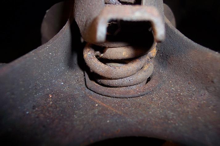

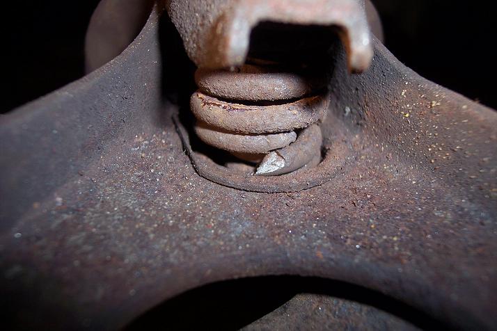

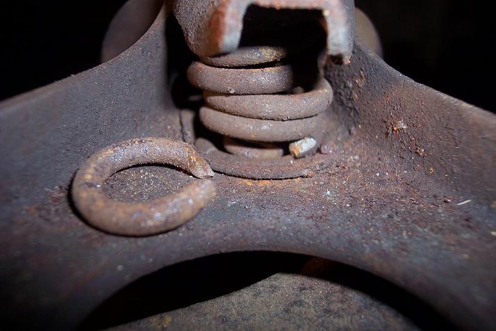

This is the reason the left clutch quit so long ago, the guy replaced the clutch pack but must have used the same pressure plate. The springs were so brittle some of them broke just taking the plate off the assy.

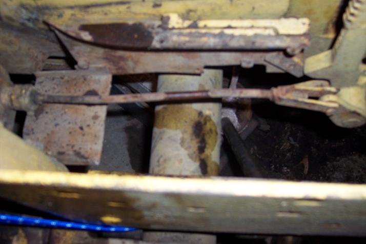

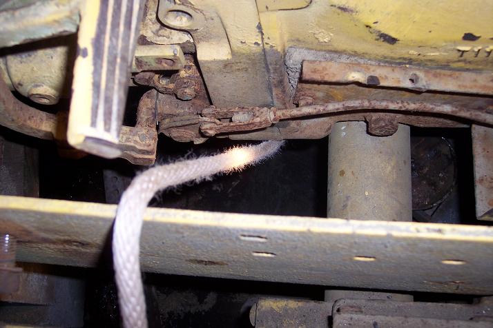

When I took off the floor panels, both brake rods were twisted all out of shape. Add it to the list.

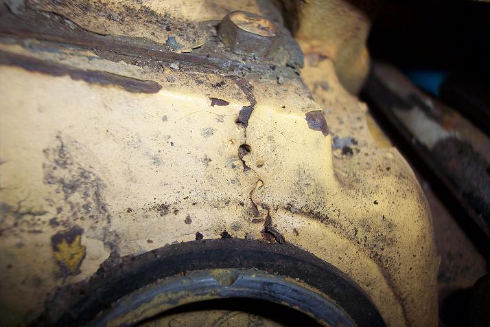

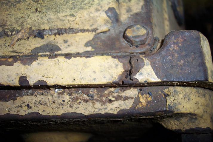

Can the final housings be welded or are they cast? I'm not a true welder, but after looking at the cracks in the right housing, I'm thinking something has to be done.
One more question, does anyone put any sort of RTV sealant around the final bolt pattern to seal out moisture? Thanks.

I know I probably preach about it, but the picture of that spring is why I do not reuse pressure plates, it is just not worth it.
The clutch housing is cast iron, it can be welded but I am a little leary of it. Too much stress on a critical part to gamble maybe.
