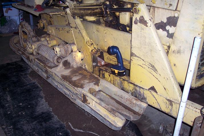

This is as far as I got on my first full day tearing everything apart.

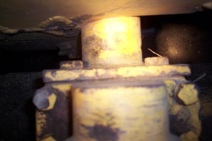

This is the right side front crossmember mount...yes, there was only one bolt on top that was coming out and the one directly underneath was bent downward almost out of the slot.

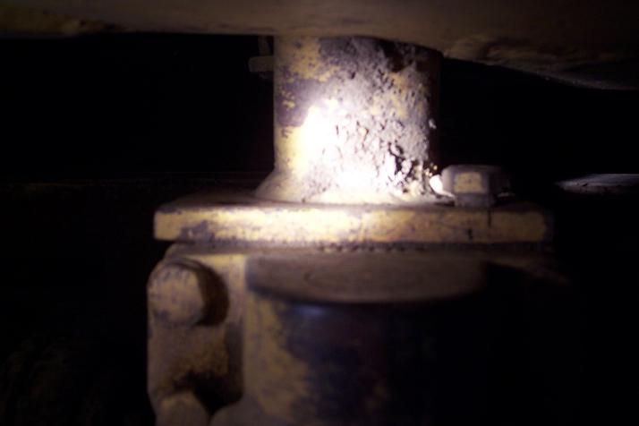

I guess this is what it should look like...

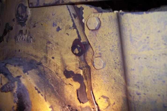

Here's a chunk missing from the right final housing...

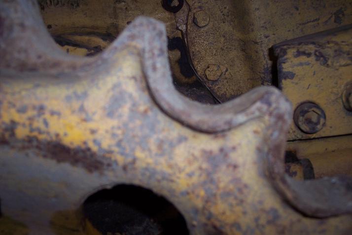

On the plus side, the sprockets look to have a lot of life left...

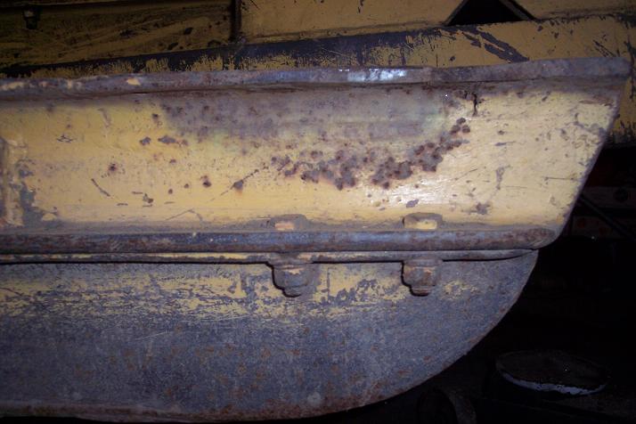

Also the front rails haven't been excessively worn from the idlers...
