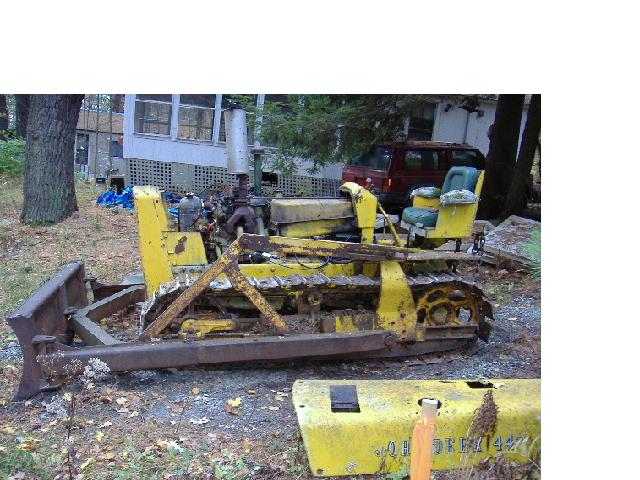

Well here's my new toy, cost me $1500 dollars and a few bucks in gas to haul her home. My 1 ton Dodge hauls her real well and this is a plus!!
Started to tear her down a few days ago. Got the blade off and one of the tracks which are badly worn. I will post more as I go. :D

Wrenchhead,
Congrats on purchase of your 440IC. Looks like most of it is there and the price was right. I also have a 440IC with 602 blade, 4 speed, no reverser, had a inopertive winch so I removed and added pto, sprocket shields, deluxe seat, hr meter, dual hydraulic control. According to serial # and chart on this website mine is a 1960 vintage.
Does yours have the following:
reverser?
pto?
4 speed or 5 speed?
daul or single hydraulic control?
Don
Eastern PA

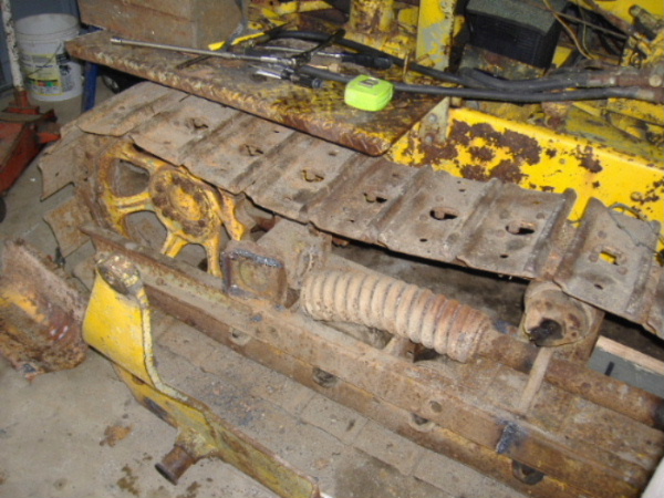

Here's a photo of the hack job done on the track frames. The bolts broke so they took and welded the blade supports onto the track frames.
I guess this whole project will take longer than I thought.
And notice the bent up, or should I say DOWN! Track tensioner spring.

Well here's a closer look at the somewhat cresent shaped track tension spring. I didn't notice it until I took the cover off it and pressure washed the six inches of dirt out of it. I got one coming from Crawler Heaven :D

Here's a pic showing the torn out metal on the Right Track Frame.
I looks like the blade support loosened up at one point in time and whoever owned the old girl just kept pushing dirt. And then broke out the arc welder to keep her running.
