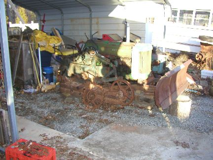

It's taken me a while to get going on this but I have finally started restoration of my 1954 5 roller 40C. I bought this machine in 2003. I named it GrubWorm as my neighbor said that's what he thought it looked like. It ran good and had nice compression so I will not have to overhaul the engine.
The tracks are a mess. I think one is not even JD chain. Certainly not for a 40 as the links are larger/longer. The other very worn. Those will be scraped and I have a nice set of 40 chain and regular pads to put on her. Of course some of the rollers are in sad shape. It steers OK but one of the brakes doesn't work too well. It has one welded clutch case so that will need replacing.
I has a JD 61 bulldozer blade that has had a second cylinder added. I'm big on originality but, I like the second cylinder and it's done pretty well, mirroring the original components on the other side.
I'm going to take it completely apart and redo it all, if I don't go bankrupt first. It may take a while as I don't have a lot of free time these days but I currently have a few weeks free to devote to getting started. I thought you guys might like to see the evolution so I'll start a journal of the project here.

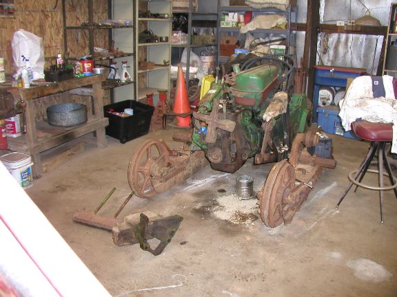

I'm back at it after summer shows and farm duties. The crawler has been moved to club shop. The move proved to be quite a chore. It was dragged into the driveway with a tractor and using 2x4's beneath the rollers. Then a big come-a-long got it onto the trailer and some help from the front end loader on the tractor.
At the shop, I had a skid steer to assist with the unloading. The concrete floor made it somewhat easier to get into place. Still using the 2x4s under the rollers helped with moving it around.
This was a couple of weeks ago and I have removed the blade and frame. I got the oil drained from the engine as the first order of business. Much to my surprise, there was a large amount of water in the oil. Not a good thing and the likely cause of the engine being stuck. About a year ago, I had a fan belt break. By the time I realized what happened, she was pretty hot. Belt changed with no apparent harm. Something must have happened to get water into the oil. I'll get the head off next and see what the top side looks like.

That is a 40 grill. It is an old one I just stuck on there to protect the radiator while moving it around. If you look at the first photos, the one that came on the crawler had the left side panel missing. I do have a nice one to finish it off with.

Found the reason she wouldn't spin. Rusted cylinders. When I pulled the head off, the head bolts were not very snug. My theory: When the fan belt broke and it got hot, it stretched the head bolts. This let cooling water into the cylinders. So it doesn't look really bad. Maybe, I'm hoping, I can clean it up and not have to bore it. I was told it was rebuilt not long before I got it. It did have good compression.
