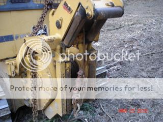

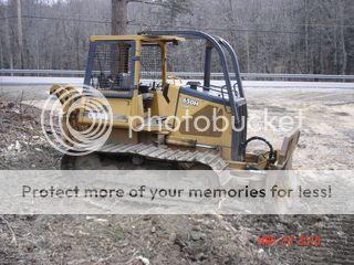

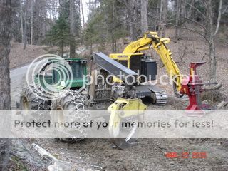

My little 420 got lonely and invited some big friends over to play.
Note the number of sliders on the 650; I use two and a grab hook on my 420. The skidder tires are over 6' in diameter, and the feller weighs over 35000 lbs. They moved a lot of wood in a hurry. Unfortunately, I didn't get a picture of the team in action with the chipper/slasher/ box trucks. This company cut, hauled and chipper two box loads of softwood chips, sorted out the saw logs, and cleaned up my site in under two days. They also did a 7 acre clear cut of a dying red pine stand for my neighbor; that took only a few days more.

Paul, thanks for sharing those photos of some equipment most of us would love to have at our disposal. That feller buncher sure would be a treat to operate! It is amazing what they did in such a short amount of time, although I'm surprised that they use keyholes instead of hooks on the sliders!

Tom: Keyholes are strong and won't splay and get sloppy like a hook can under the forces these big winches can generate. My equipment had much smaller winches, and I never had a problem bending hooks. I liked that I could sometimes hook with one hand moving only the choker weight close to the hook when cinching; keyholes almost always require two hands and handling the weight of the whole chain as it got threaded through the eye and onto the cinch link. Just a personal preference based on how I was taught and what I experienced. The 650 owner has a lot of experience and likes his setup as well. Btw, he only has 50' of 5/8" cable on this machine and used a swaged end stop to keep the sliders on.
Notice how his lower fair leads look like yours? This 650 set up can be run to hoist the load, or rethread the cable for straight pulls. How the cable is run is determined by how the machine is being used, and can be switched fairly easily. Paul

Wow 50 feet of cable! I'm definitely going to cut some off of mine, the more I use the winch I am realizing I do not need as much cable as I originally thought. I really like the upper fairleads on that 650 although I don't think our little 420's would steer at all with a setup like that!

Tom: An integral arch is a nice thing, but in my opinion, not on a machine as small as ours. If a hitch is light relative to the machine's weight, an integral arch will lift the choker end of the hitch off the ground reducing drag and dirty logs. If the load is heavy, the leverage will leave the machine "pawing the sky" as the leverage is in favor of the load and not the machine. This means that the load is on the finals and last rolls and not on all the ground bearing track. This also means that there is less real traction and more strain on the whole system.
That said, an integral arch is an asset if you "load light, bind tight" and treat your machine with respect for its capabilities (I had one on each of my 350 and 450 dozers - significantly heavier machines than a 420, 430, or 440. I ran a different number of sliders on each of these machines to balance the load/arch capabilities).
That said, running a winch without an integral arch allows for straighter pulls that puts the forces of the load more along the horizontal axis of the machine which engages more grousers and greater traction with less strain on the finals.
So if the dozer is being used for bunching or short hauls, no arch is needed. If the machine is being used for longer hauls, an integral arch is nice since it lifts the load for less drag and cleaner wood.
A smaller machine can run an independent tow behind arch quite effectively since the load forces are transferred to the crawler drive train in in a way that uses the system better. Just my thoughts. Others may have differing views. Paul
