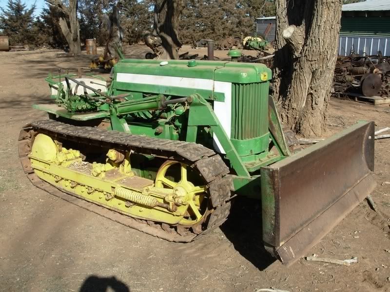

Looks like there will be an estate auction March 25 thru 28 in Hart Texas that includes a 420C. www.nixonauctioneers.com
Can this be a 6-way blade from all the hyd. valves?

That is a 62 blade, so manual 6 way. The valve is a standard dual valve, nothing odd there. They look weird because Deere stacked 4 single valve side by side to make 2-two way valves. Realistically not the best setup, the 440 vavle is much simpler, but then again, Deere did not make it.
