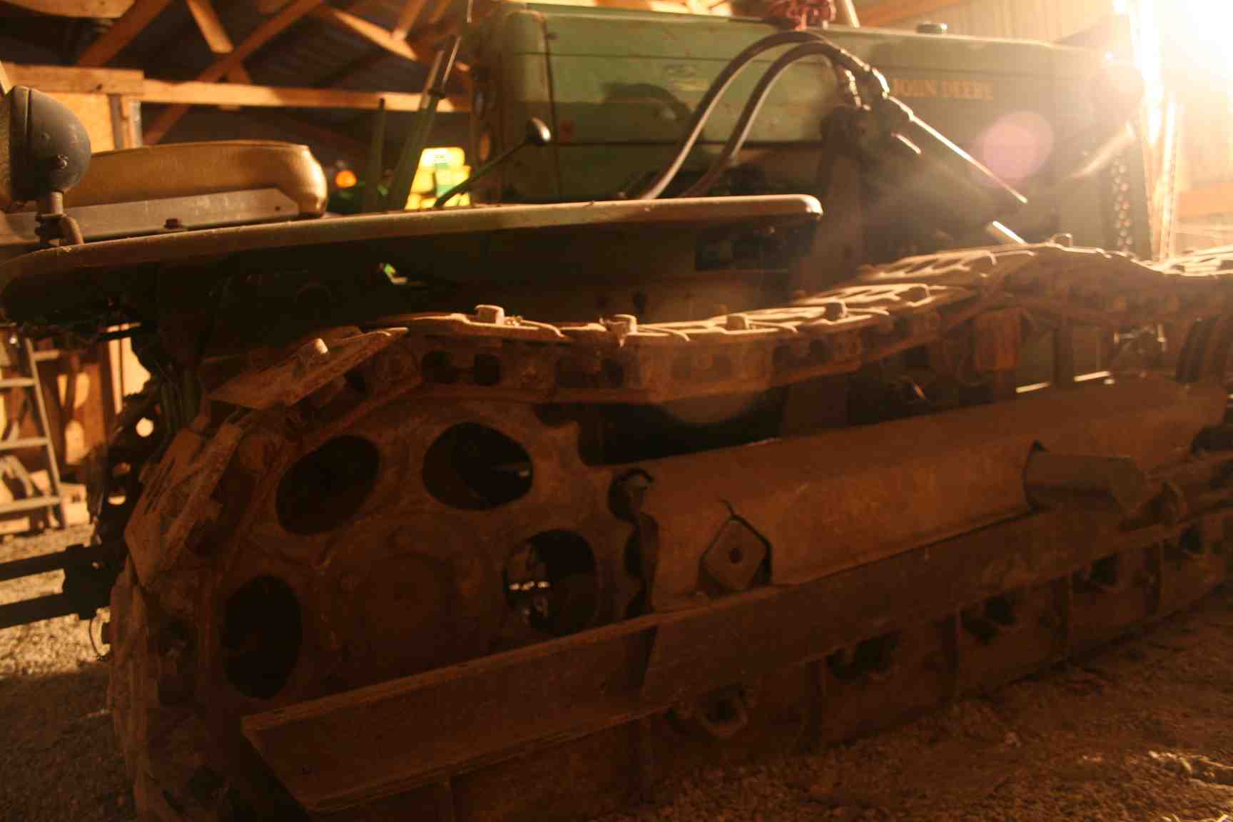

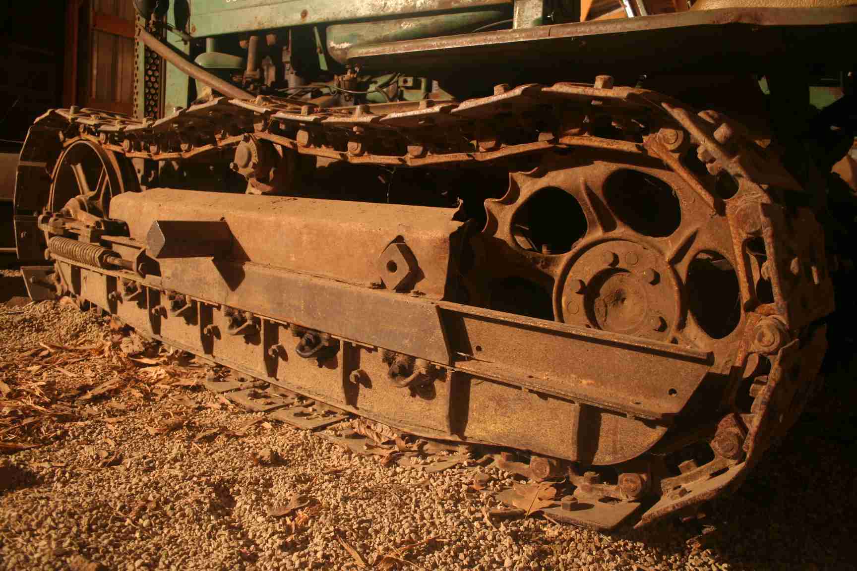

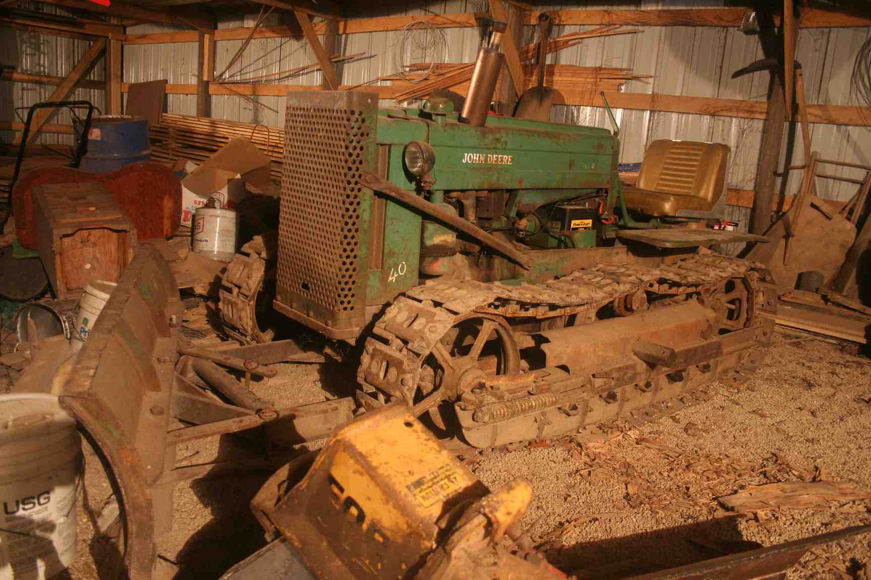

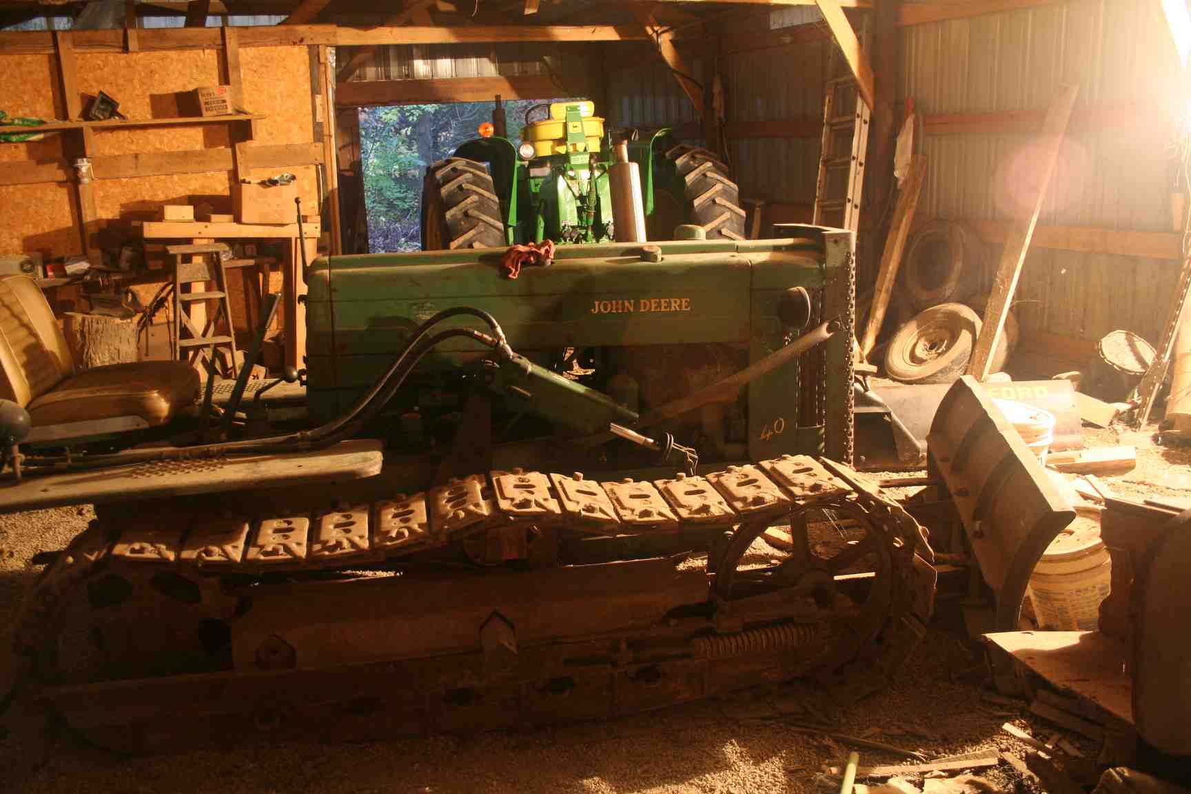

Here is what I do know, this is a 1955 5 roller 40c serial #714**. I was wondering if anyone could tell how good of shape the tracks on this crawler are. I am in college and purchased it a few years ago for just a little over $900.00. I know the idler on the left side needs to be replaced. I have not taken it out of the neighbors shed for 2 years but I just started it up again the other day and it still runs well. The left side track does not drive I was wondering if anyone could give my some possible things to look for. I know there is way too much sag in the tracks as well. I think this is adjusted by the spring tensioner, am I correct on this? If so what direction do the nuts need to be turned to get it to tighten. The fuel cap got robbed off of it by my father because he lost the one off of our 3010, thats the neighbors 4020 in the one picture though. I would appreciate anything anyone can tell me what they think I may need to get it back into proper working order and how much life they think is left on the tracks.

Judging by how far the idler brackets are out on the trackframe, I am afraid you are quite a ways out of spec as far as the pins and bushings. In one of the pics it looks like the sprockets are getting thin on the flanges, but no sense doing anything with that until you get the tracks rebushed.
Not driving on the one side could be as little as an adjustment, or as bad as a broken component. Look for factory parts and service manuals if you don't already have them.
