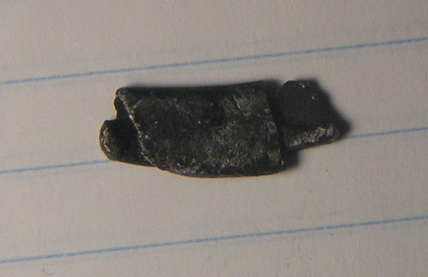

I have added a photo of a piece of metal that I found in the engine. I thought that this metal may have come off the air cleaner. The lines on the background sheet of paper are 1/4" apart.
Anyone have any idea where it came from?

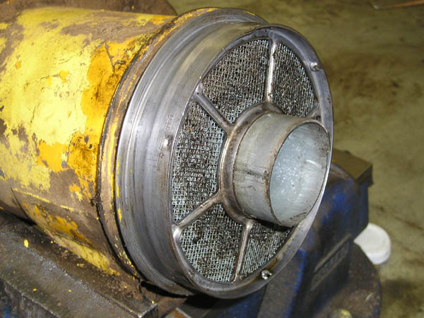

Looking at the first picture the distance from the edge of the ruler to the edge of the cannister is 1/2". With all the gunk on mine its hard to see that mine is anything like yours inside.
Since I bought the crawler not running and am still working on the engine I never bothered to pull the air cleaner off. I found out this evening that I don't have the cup or bowl that holds the oil
I guess now I have to try and locate one of those.
Hope the pictures give you the information you need.

I think that the down tube on your air cleaner has also been trimmed. There is no way that it would reach into the oil bath.

Derek,
I'm not so sure about that. I'm going to look at a couple of other oil bath air cleaners I have laying around. It was my impression that the oil was supposed to splash around and just keep the screen mesh damp with oil. If the tube is down in the oil I doubt that the engine would breath very well. At least thats the way its been described to me in the past.

The piece of metal couldn't have come from the air cleaner, at least not the tube on the bottom anyway. On these oil bath air cleaners the fresh air comes down the center tube, through the oil, up the wire mesh screens, and then to the engine. So any stray pieces of metal should have been in the bowl with the oil.

It may be possible that the piece of metal is from the choke plate flapper.
Pull your intake hose to carb off and look at the choke plate. If you have a opening in the plate (about 3/8" by 1/2" half round) than you are missing your choke plate flapper. Its spring loaded to let air in but not back out (when choke is closed).

The choke plate flapper is missing and the crawler has been harder to start lately. Much harder now that the cylinder head is off. I guess I'll have to track down a replacement or make a new choke plate flapper.

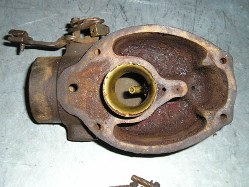

I took my carburetor apart and it looks very rusty. I wonder how the crawler ever ran. Does anyone have any suggestions on how to clean it up?

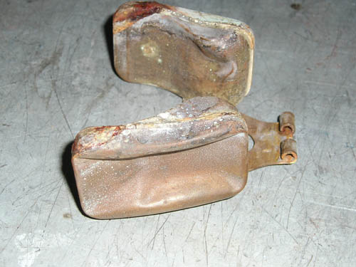

Finally, my carburetor floats look deflated. Any suggestions on how to restore them to usable condition?

The float is cheap; $12 or so on eBay and less than $20 almost anywhere else. The flapper shouldn't be too hard to find either. I'll look around and send post a link when I get a chance to look tonight.
