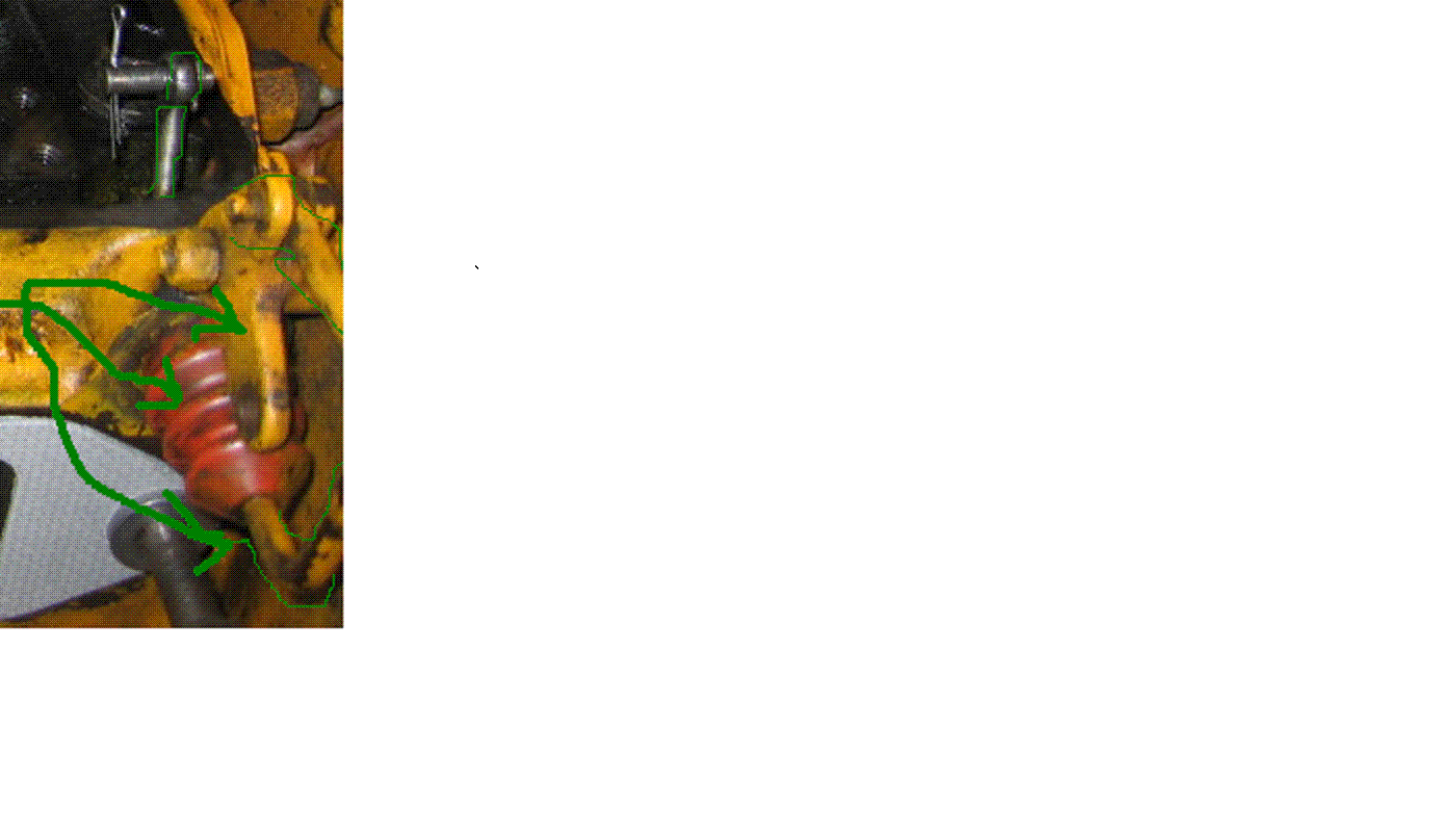

drained oil today. A little water in the beginning came out. Friend of mine gave me his manual today, have been reading it like crazy. Learned some tips to start it also. Like draining fuel filter for water. I'm missing the governor linkage. The part that is attached to the throttle rack and is shaped like a C. Does anyone have that or know part #.

The part listed above is actually mounted on the governor and is called; lever, governor throttle speed adjusting shaft. Is that the part you need or the C shaped part that runs thru the side of the head in to the rack? It is 5121240, link, and the rubber boot, that seals the side of the head, is 5121385; boot, governor control link. HTH

The snow storm we had this weekend has kept me busy. Here is a picture of what I need, not my tractor though. Someone's on here. Took off fuel filter not sure what happened there, but I will replace filter anyways. [[/img]Image

I finally got the picture up that I needed. I have the filter on order and now I have need a warm day.

Two of the arrows in the picture you posted point to the line and boot I listed the part numbers for previously. You appear to be missing the Rod, governor to injector link (p/n 5121239) and two joint, ball, 1/4" (p/n 5118491) and the jam nuts Nut, hex, 1/4" (p/n 121904). You really nead a parts list PC-609 for the 440ICD. The date on mine is Jan 66, and I believe that was the newest version. HTH
