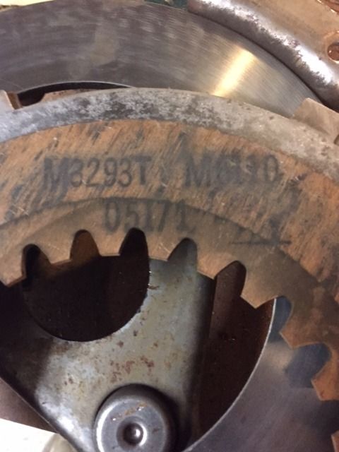

Clutch discs
http://i1075.photobucket.com/albums/w42 ... w5y8li.jpg

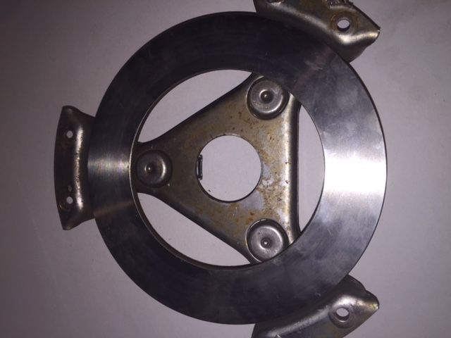

Pressure plate
http://i1075.photobucket.com/albums/w42 ... 45ubep.jpg

Something is odd with the wear pattern on the one fiber disc, it appears to be only on the very outside, this is not right.
The clips are from the pressure plate levers, someone left them on when installing the pressure plate, they should not be there. If the clips were on when the clutch was assembled, chances are the pressure plate was never adjusted. This may not be the problem, but worth checking.
I think I have some of the bolts on hand, would have to check.

Lavoy what you are seeing is actually a steel behind the fiber I had to look a few times at that pic my self :? :?
Post by Lavoy » Tue Jan 12, 2016 4:17 pm
Ok, that makes more sense.

Yes exactly, the clutch discs look brand new, with the part number still on them, the picture does show the disc on top of a steel in the background.
