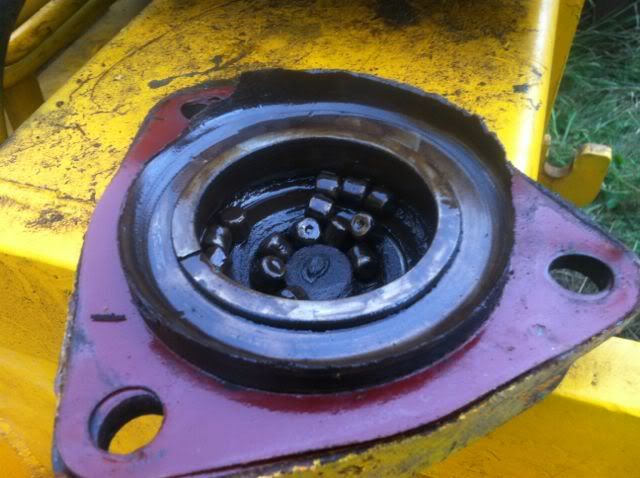

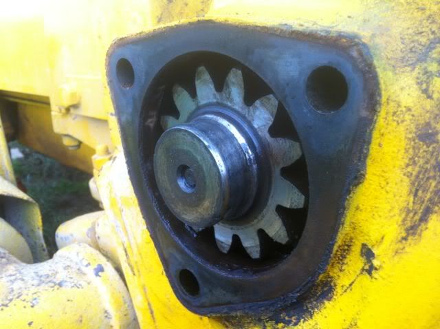

I finally decided to rebuild the left steering clutch and started to disassemble today.
When I pulled the final drive pinion shaft cover I discovered that the bearing was toast and had chewed up the cover and the pinion shaft.
I pull the whole final and see what other damage there is. I am going to have to go on a treasure hunt....

Almost makes me.afraid to pull the final on my 420 project. :lol:
Post by Lavoy » Mon Aug 13, 2012 7:59 am
Yeah, I know what you mean, just went through this with both finals on the 440. But, if I hadn't, something would have broken in relatively short order, so just as well do it.

That's how I see it too. I'm already almost there so do it right.
