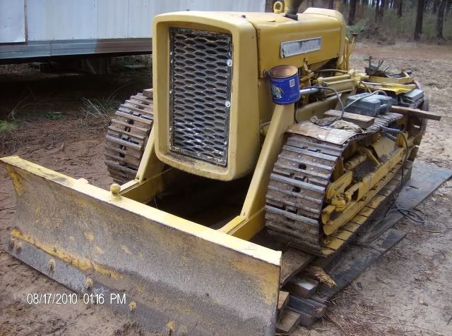

If I spin engine I can see clutch and pressure plate and shaft turning, but nothing turns in the reverser or the transmission. If I turn pto shaft it spins the reverser. Is it possible that the clutch shaft slid forward and disengaged the reverser? When I was replacing engine, the shaft came out with the clutch. Thanks

It has been some time since I started this project but I finaly got the motor pulled today and found the problem! The main shaft is broken in two pieces, and now trying to get other half out? Anyone know a simple way? A magnet hasn't worked! Will be looking for another shaft if anyone has one, let me know. Thanks, Sam

Broken clutch shaft causing the problem! I just worked the broken part out with a magnet and long screwdriver with magnet in shaft hole and screwdriver in reverser [side plate off] working the broken part of the shaft and holding pressure with magnet. Finally got it moving and out. Now looking for a shaft. Does anyone have any idea where I might find one? Please let me know. The shaft is from clutch thru reverser, it is approximately 20.5 inches long,1 3/8" With10 splines and 1 3/16" with 16 splines [aproximate] This is for a JD440 with a reverser.
