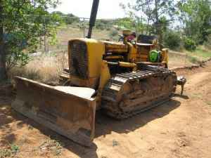

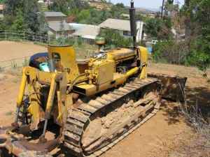

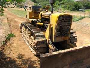

I have begun the search for a crawler to do some light dozer work and some road maintenance at my place in N.D. I found this 2010 on craigslist and looks like a worthy project. I am a fairly competent mechanic and am not afraid of a project, just don't need another huge project. The seller states:
1952 John Deere 2010 crawler to good home; a little smaller than a D-4 (10,000 Lb unit) all hydraulic with 4 cylinder diesel, six way blade in front deep rippers in back, 8 speed transmission, undercarriage, rebuilt injection pump, injectors and radiator. Does not run and I don't know why.
Seller would like to trade for an old 8N tractor I have.

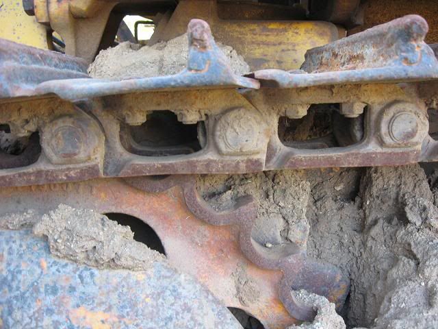

Does this look like a solid dozer?

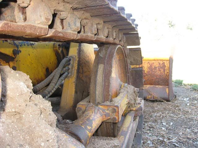

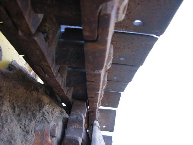

Why is there kind of a cupping effect on the tracks where they meet the sprockets?
Looking for some input concerning the shape of the undercarriage and really just anything else the experts might notice.

I have the same unit and like mine so well I rebuilt it this winter. For what you are looking to do it will work well.Parts are getting tough to get but it can still be done. It will do a lot more then your tractor... Paul

The rails look pretty good, they have been rebushed at some time. Sprockets look good, and a power 6 way, I would already have it home and the Ford gone.

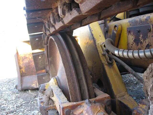

the tracks look good to me but they appear to be way to tight.

I finally was able to look at the pics, and it appears to be a solid machine. The right-side rails appear to be just a tad thinner than the left side rails, but otherwise undercarriage looks solid. I do agree that tracks appear to be too tight but that is easily remedied.
The scarifier has teeth in it; my understanding that is hard to come by. I would want to get the hood for it over the fuel tank, but that shouldn't be too big a deal.
