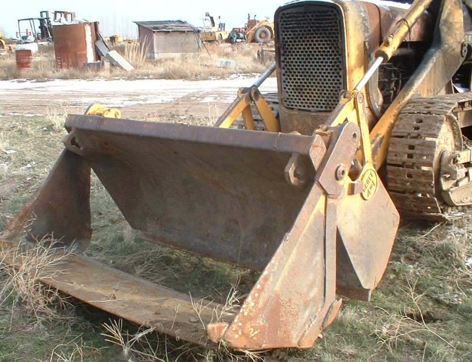

Ever seen a 4 in 1 bucket blade for the 2010? Check it out:
http://www.tpaktopc.net/images/johndeer ... BUCKET.JPG
These folks have it for sale - as well as 2010 used parts I imagine:
http://www.tpaktopc.net/john_deere.htm

As for the Drott 4in1 bucket at General Gear and Machine in Boise (the ones in the links), I have e-mailed them previously and they told me the one in those pics had been sold. I would sure love to have one of those buckets- the ones I have seen in person are for larger machines and usually have a "fishmouth".
The front idlers are part number AT 12417 thru Deere. They were $194.67 each. I got the sprockets from a person that had bought a lot of dealer close out parts. He only had two. I made a pattern out of one of the new sprockets and plan on trying to build up and machine the old sprockets. If everything goes right I think I'm going to be able to have a pretty decent set of sprockets for the loader. We will see.
